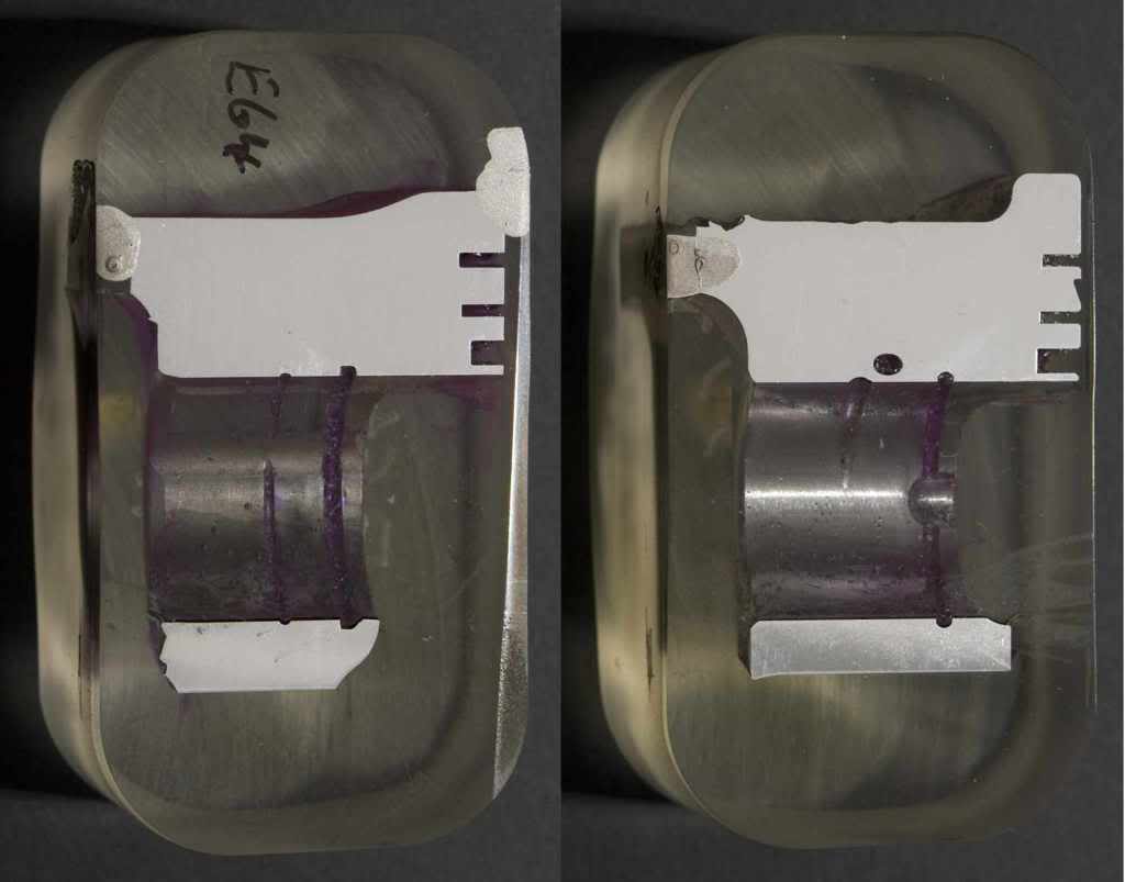

I am curious why they built a turbo piston that also requires the deck height changed as well... why would they not build the piston to just work on a stock deck height?

certainly not... the pistons we had made always had a thicker crown than the stockers.. all we had to do was move the wrist pin up on a blank and machine the dish in the piston (they typically looked like flat tops but with the wrist pin moved, the CR was down about 2 points....
guessing that weight is at such a premium on bikes, I suppose it makes sense to keep every gram off the motor possible.. Guess a guy needs to cross section a slug to see just how much is there.. thanks for the info :)
cdhoroho
Jul 17, 2006
767
someone has cross sections a stock vs je
pics below
je on lhs
je on rhs
see the bottom ring landing in bottom picture is very near the wrist pin hole
