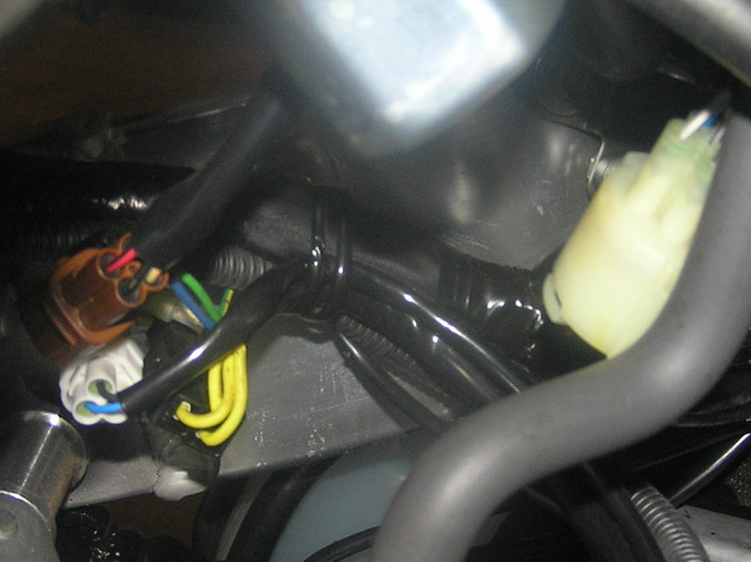

Does anyone have any pictures showing exactly where the Ivan TRE plugs in? I think I know but not exactly sure...
I lifted my tank and it's a tight squeeze in there and don't really feel like taking off the left side plastic, but I'll do it if needed. Please help! Thanks.

I just installed 1 on my bike tonight and it was easier to do it from the right side of the bike. Once you move to the right side it's real easy to see the plug where the the tre goes. Hope this helps, Dave

I did not take off the plastics, just raise the tank and you'll see it.

I think I got it right....
Is this the way it's supposed to "hang"?

Can somebody chime in and tell me if I have the tre secured properly as shown in the above photo? Is it fine just like it's shown or do I need to tape it to other wires to make it more secure? Just wondering....
Thanks.

taping, zip tying, whatever surely will not hurt anything, so go ahead and do it to be safe.

(badassbusa03 @ Sep. 14 2006,04:47) taping, zip tying, whatever surely will not hurt anything, so go ahead and do it to be safe.
+1 I zip tied mine to the brown connector shown above it...just so it would stay out the way a bit.

I would definetly zip-tie it to something Pan . Hanging from the connectors will eventually cause wear issues .
