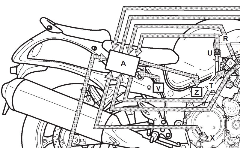

TOS is located on the RHS under the side cover then? "V" Is this where you unplug it?
I remember the Gen2 tip over sensor being in front of the gas tank hinge, at least it was on my '08.
Regardless of where it is, it will have a short two pin harness on it, just unplug it, then take a jumper wire and connect the two wires in the plug on the harness on the bike, which will complete the circuit and allow the bike to start.
Tip-over sensors rarely fail, it does happen, but more often they just get stuck once they are tripped/the bike and switch are laid over or upside down.
Give them a good shake and the internal switch will come loose again.
It is a simple gravity switch, that breaks the connection when the bike reaches an angle that fuel can leak past the gas cap.
On a Gen1 it is located on the RHS near the fuel tank hinge, under the frame cross-member.
That correlates with the Gen-II manual.

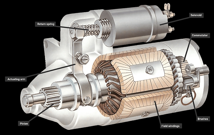

I couldn't count the number of threads where riders went on to replace fuel pumps and filters and injectors, all to no avail, only to find it something simple all along. It's a peculiar human trait it seems to miss the obvious simple things. I did myself once years ago when a starter motor in the bellhousing of a car I owned was malfunctioning due to clutch dust buildup on the shaft the pinion gear runs up and down. I replaced the battery, then the alternator, then was in the process of replacing the starter motor when I discovered the issue. That was a Ford of course! I steer well clear of those cars, and GM. Japanese for Bikes and Cars is the secret to a happy life.
