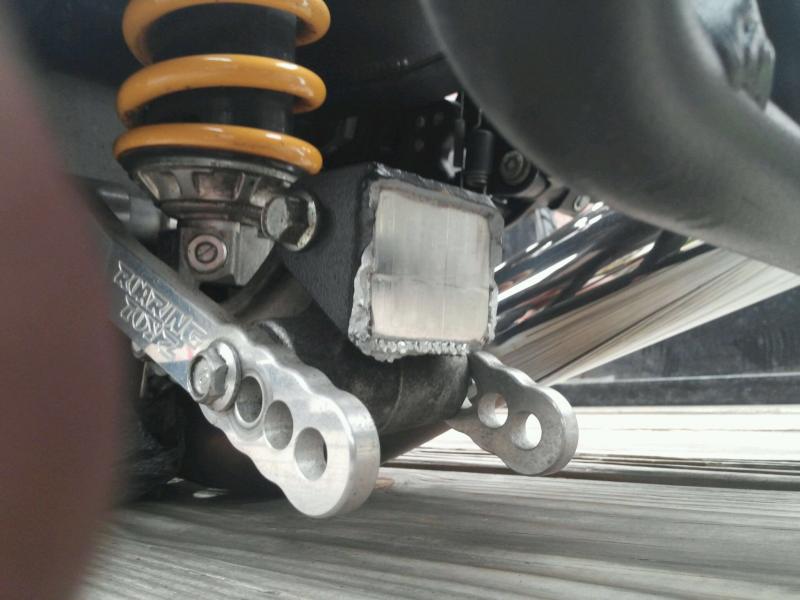

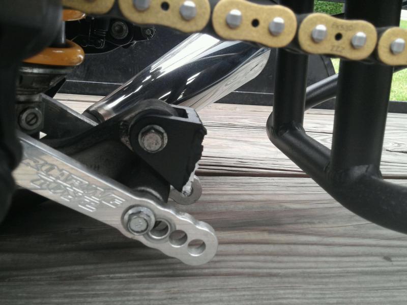

I wouldn't consider an evil or Adams arm a real arm. I can't tell you how many of those arms I've seen the dogbone pivots have gotten ripped off of. I actually have a turbo 1000 coming to the shop this week for just that reason.
That doesn't look like any Adams arm I have ever seen.
I've been running adams for the last 13 years and I've never had a problem.

Alumipro. go up on psychobike and put a WTB add. doesn't matter wat it looks like. I bought mine used for $600. had it powder coated and put a brand new Macintosh sticker on it and it looks brand new!
otherwise, ur lookn at $1500 with chain guard and hugger and a very long wait this time of year. I think the DME one is probably just as good like Rob said but id say over 80% of the PST bikes run a Macintosh for a reason.
Mcintosh is by far the best. Dme and velocity are awesome too. Those little skinny evil and adams are dangerous. I haven't seen many arms fail over the years, but the ones I have seen fail are those 2. Take it for what it's worth, I'd rather have the piece of mind and maybe a little extra weight. Better then laying your bike down, and or personal injury.
So post pics of those broken adams arms.
Some of the fastest grudge bikes in the country run adams arms with no failures.
Search the Internet, they are out there. Most of those pics were on PB, and guess who the main sponsors are? Evil and Adams. There was a broken evil arm on the PB FACEBOOK page a few weeks ago and that got taken down quickly. I also got banned just for saying, "oh look, there's another broken one."
I have an Adams-modded arm on my Gen1,worked great for the last 10yrs while the bike was N/A. Slapped the big turbo on it,now the arm is twisted and needs to be replaced. I'll be doing what I did with my K5 1K,ordering a McIntosh alumipro
Evil I believe. Adams eh. I have yet to see one.
I did search. Found evil but no adams.
