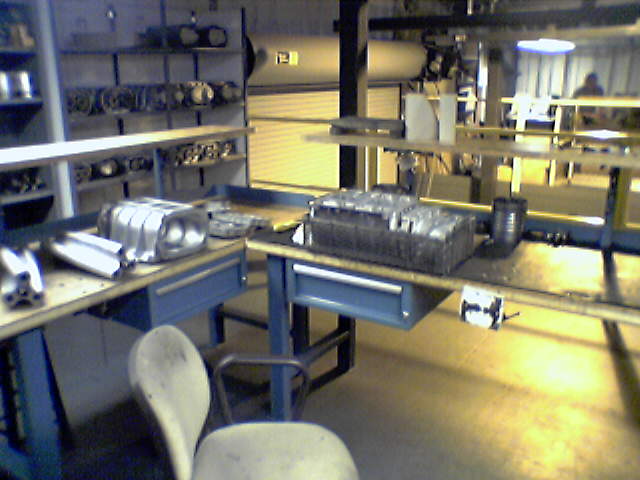

hey had no idea! how much to go through hi-helix units and restrip them? (and not that tiny thing either) :rofl:
been doing superchargers and turbos every day for the last 5 years on a goverment contract. they are all for diesel engines and have no strips but are the same otherwise. i know an O/H kit for a 671(which are pictured above) is about $190-$200 and includes bearings,sleeves,seals,shims and gaskets. takes a couple of hours to go through one, i send mine down to our corrision dept to be blasted with plastic media before smoothing it out and putting it back together..the most important thing is to get the rotors timed right (the "C" and "CC" measurements) and all the rotor to case clearances correct .
