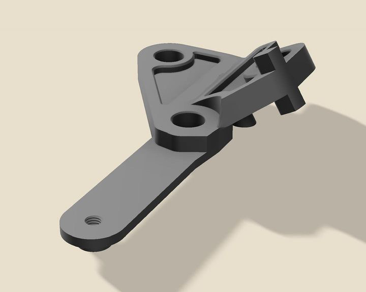

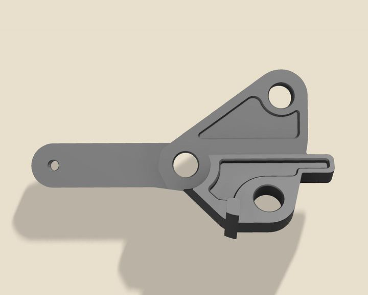

This time I’m working on a kickstand mount replacement that will be machined from 6061.
What I’m showing here in this post is the base geometry to align everything. I will be making a few slight changes to the swing of the stand and the angle that it kicks out to allow our bikes to more safely sit on the stand, especially after lowering. I will also be removing extra material after running some simulations.
The final version will likely drop roughly 10-12oz.
