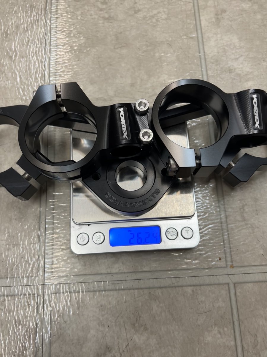

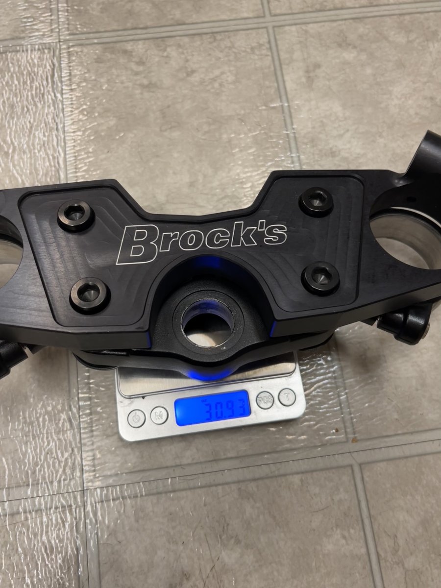

Unit 5 clamp finally showed up. I’m actually quite surprised it isn’t lighter… To be fair, my OEM clamp was lightened by removing the ignition switch section and adding holes to the center but still…. The clamp paired with Vortex clip ons really only dropped 4.5oz… It is WAY more attractive than just using the OEM clamp with clip ons though.
In case anyone did not know this, the Vortex clip ons are not a good option for us. The clamp/bolts for the bars facing upwards means that that area has too much material to allow the reservoirs to sit correctly. My levers are facing downward and just will not work. I have a set of Bonamici clip ons on the way to replace these.

If u do the whole setup... complete triples trees. ignition bracket and bars... it saves around 5 pounds over stock. ALSO included in the package is the unit 5 Nut... And a montgomery CF tank weighs around 5 pounds.. a stock tank weighs 14/15. I did find a custom CF fabricator to build me a true CF 5 gallon tank tho........ but im not sharing that fabricators info right now. Its still in the works. Fabricator is in italy. Joint project.

And I wouldn’t even call these high quality photos. I almost didn’t even post them since they were phone pics haha. I’m really happy with the look and quality of the clamp.

This is what I’ve heard. So I suppose I’m going to get that lower one on my list for the future. Montgomery tank was actually more like 6.5 for me iirc.
When it comes to this upper clamp, I’m comparing it against my pair of upper clamps that have already been modified so that’s why I said to be fair to Unit 5, my numbers are a little skewed and not what the average customer is going to see. I had previously deleted the ignition switch and cut the bracket off, as well as add holes to the lower clamp while I was waiting for his to come in. So I unfortunately do not know the exact weight savings I saw. I’m only surprised at the fact that compared to two full size clamps it’s not much lighter. I should have compared weight for lower vs lower, and upper vs clip ons. That way I know where that weight is

BUT... the triple stalk in the middle of the triple clamp that connects everything is made of titanium and the nuts and bolts are titanium or alloy... the real weight savings is that middle connecting stalk... i think anyway. its comically light in your hands. u can communicate directly with him here.. he writes back. Для просмотра нужно войти или зарегистрироваться.. i paid almost 1000 bucks for the whole setup and shipping from canada... not bad for 5 pounds weight loss.
