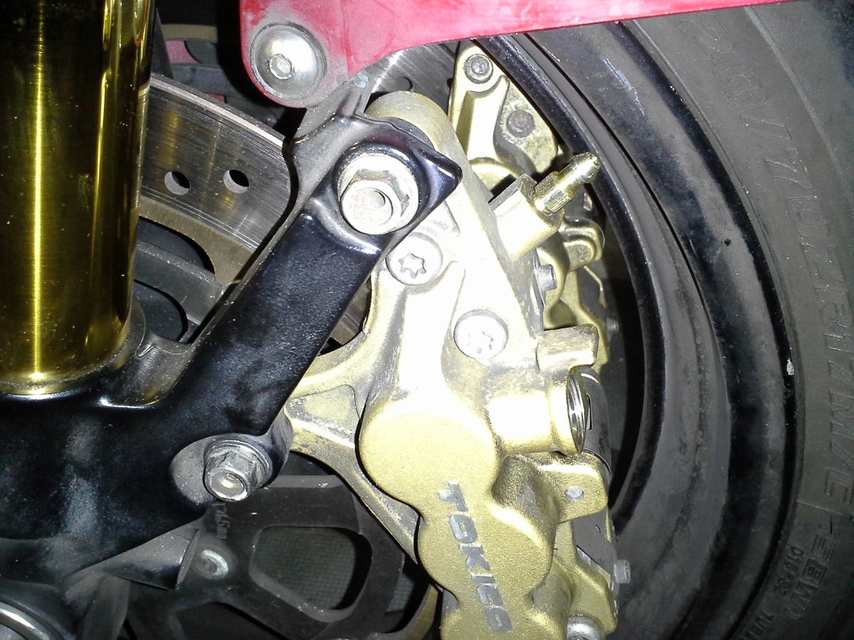

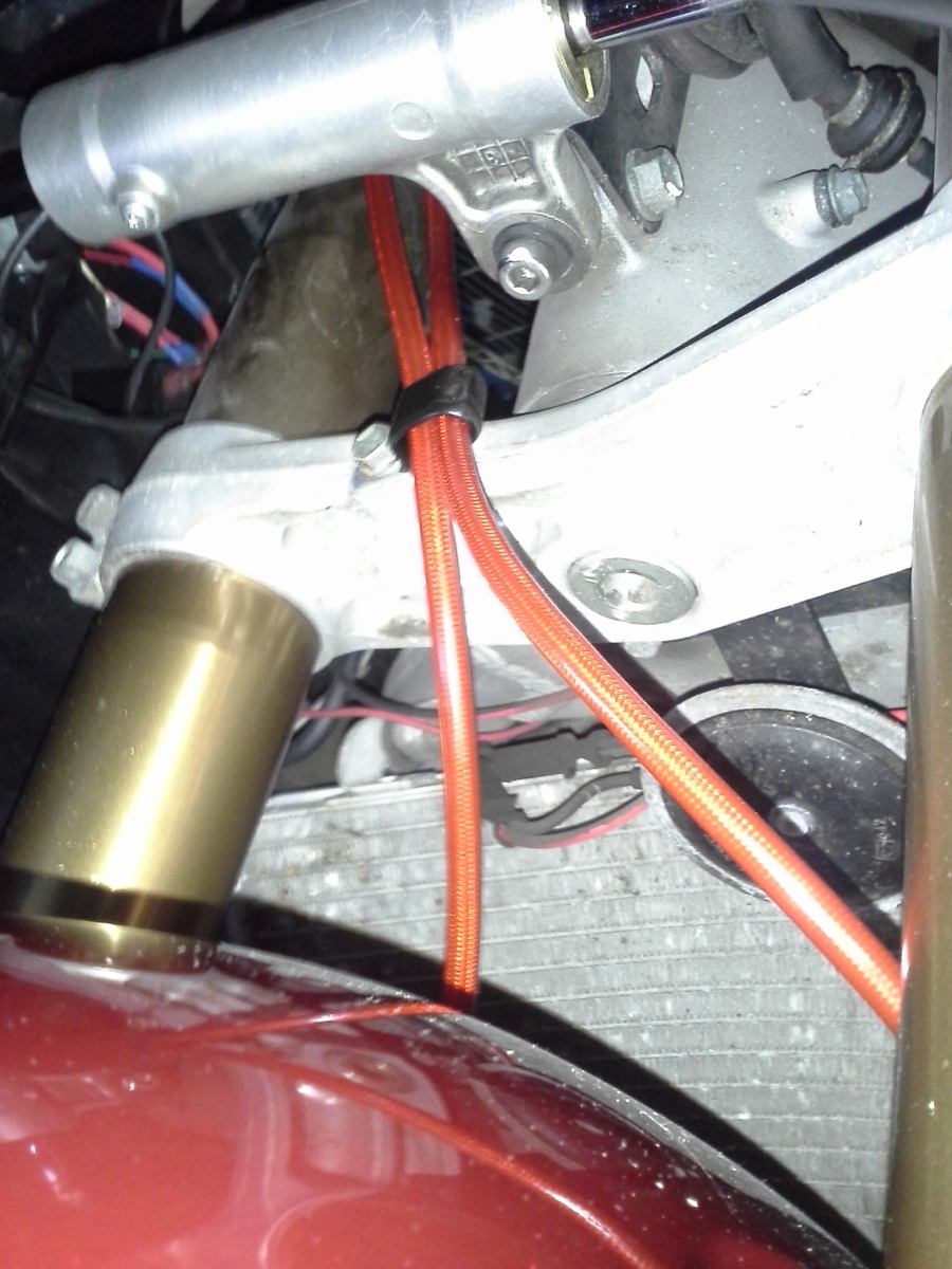

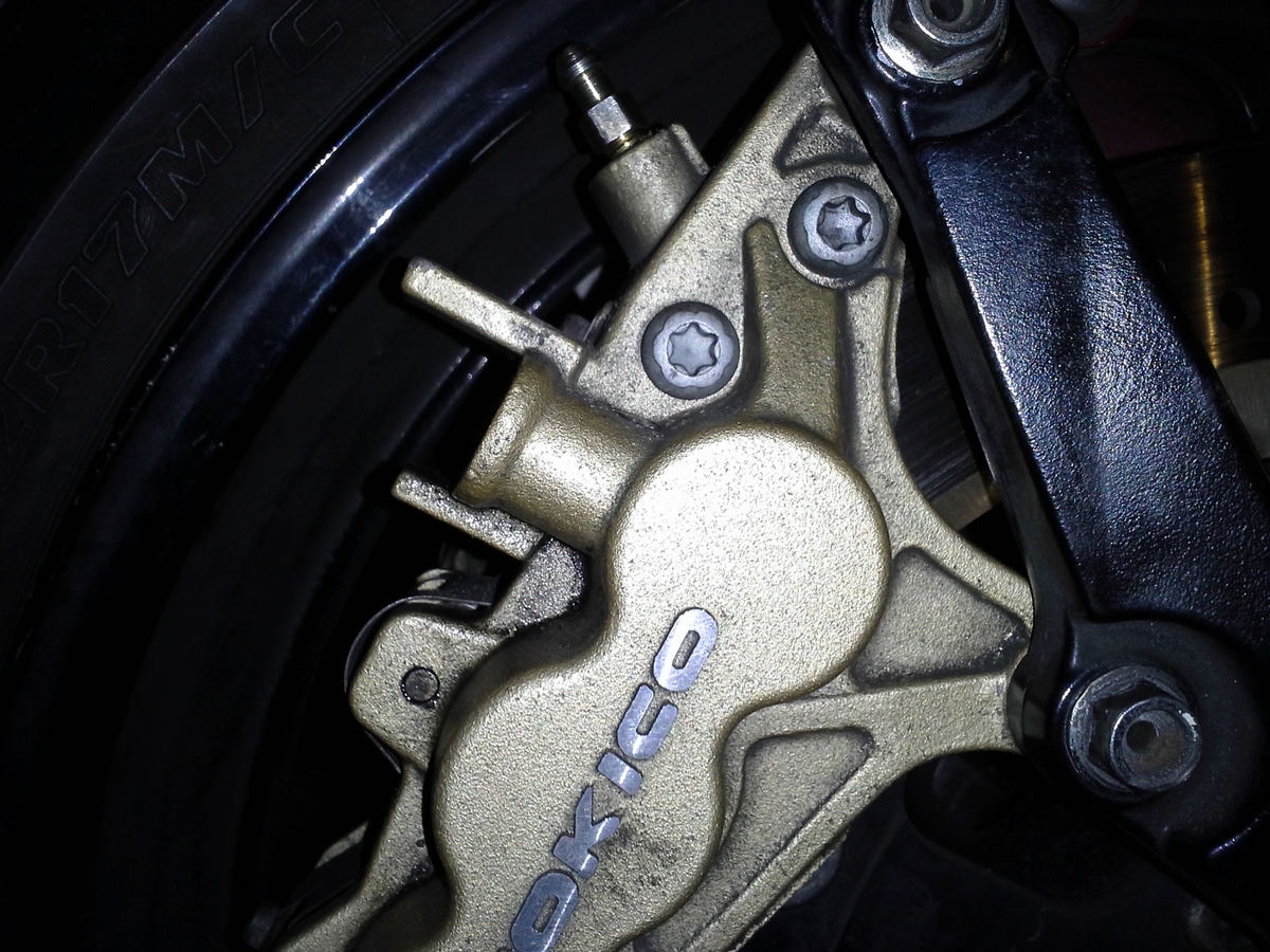

A picture is worth a thousand words, so...
Also, I replaced stock bleed screws with speed bleeders, which makes bleeding really convenient. Not something you do every day, so it was a rather slow and careful process. Tightening carefully to 15 ft lb, checking for leaks, bleeding, etc.
I have to say that I drained all fluid with my vacuum pump (similar to MightyVac) first in order to get rid of the old fluid. The fluid was reddish dark - really needed to be replaced anyway. When the system is empty, vacuum is the only way to fill it initially. Interestingly (and this is not the first time I observe this), using vacuum does not get rid of all the air. Although the fluid was coming out without any bubbles, I believe there were small pockets of air, and therefore no amount of vacuum pumping would get rid of it. The lever was somewhat mushy. However, when I used only lever about 5-7 times for each caliper in order to bleed the system, I could completely get rid of air, and the brake lever got as hard as it gets.
