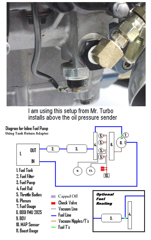

1. What is the BEST\SAFEST location on the engine to pull out the oil to feed the turbo? Pictures would be great because I don't know all the propor names for some specific parts.

3. I will be running a blow off valve underneith the gas tank just before entering the plenum, where would I get the vacumm from?

well, i myself am installing a turbo to my Busa, so maybe I can help you a bit.
1. see the image below, I bought an adapter from mr turbo where I am getting the oil feed.
2. take your time and read this forum A LOT !!! there are some excellent guys on here that really are helpful.
3. See the image.. you will be getting it from the throttle bodies vaccum pipes.
4. I have seen most guys remove their oil cooler, I tried to fit mine last night but there is no space for it.. Im running a pipe between the oil holes that the oil cooler connects to.. they say thats ok..

My setup is very similar and uses just a brass tee where the oil pressure sensor is. One side goes to the oil feed and the other to the sensor.
