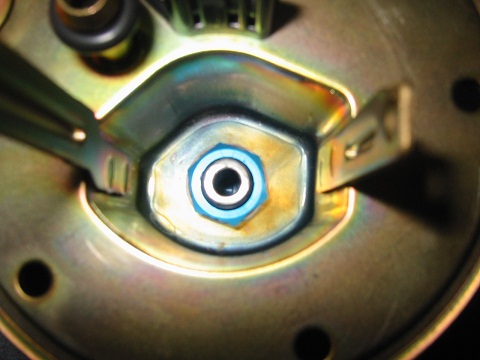

The pic below is where the stock pump used to be. This is what holds the stock pump in the tank. You can see where the fuel lines come in and out. With the turbo install you remove the pump and regulator from the tank. It's gutted. The fuel return line goes straight from the FMU to the tank with no check valve.
