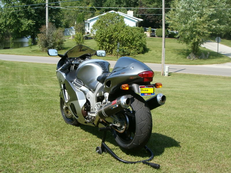

Well, I got my parts yesterday, and tonight I will be doing the Pair valve mod. I am going to remove the valve and the lines, block airbox hose and vacuum hose. Seems like a good time to do it with the weather being cold. Tomorrow I will do the +1" dogbone links.

 I got both jobs done.
  I decided to go ahead and do the +1" rear links also, I'll have to try to test drive the bike another day. Hopefully, it will handle a little better and the kackling out of the exhaust will be gone. Keep you all posted.

I got to test drive the Busa after the mods. I went through a couple of S turns a couple of times and high speed sweeper and I got to admit , it handles alot better. The Busa is alot easier to flick it side to side, and more clearence. The cackling is also gone, sounds great. I would recommend the +1" rear link to anybody that likes cornering, totally a different bike in that aspect. Oh, and cheap to do.
