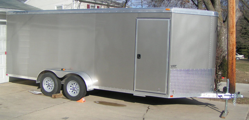

So I got the new trailer a couple weeks ago and have been to every trailer supply site on the internet looking for what to buy as far as floor tie downs. I know about the Baxley chocks and will have a pair of the when to bank account will allow. I want to set the trailer up to haul 4 bikes and want to buy flush mount 360 degree tie downs that look good. Looking for suggestions I need to buy maybe 16 of them.

Yes they are I stole it from a farm down in Arkansas ther was a bunch of them there. Think they will miss it?My plan is to use this thing as a storage shed when not doing motorcycle duty. I want to be able to haul 4 bikes. 14 foot might have done it. 16 would do OK. This one there will be no worries. I look at this like I did my garage when it was empty it looked huge and now it full and I wish it was bigger.Besides I got to haul brats to the Bash so maybe I got enough room?
