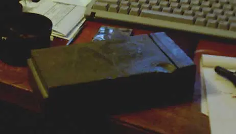

I make my own weights.
Front usually needs no more than 8 grams, the rear no more than 20 grams. I probably would not notice much by not balancing them.
