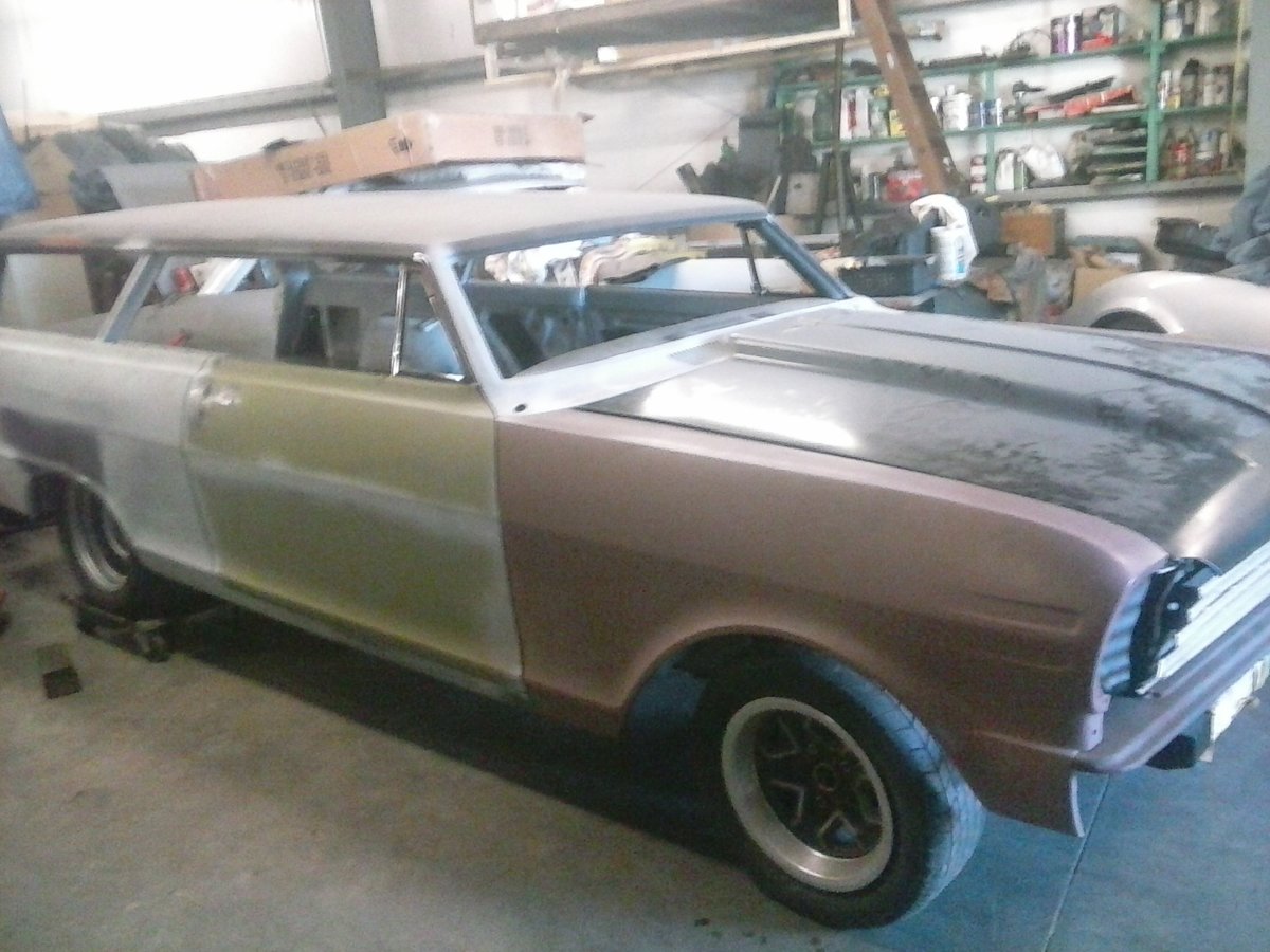

Love the wagon! I always love wagons - they are real street cars for guys with lots of stuff! Cheers
