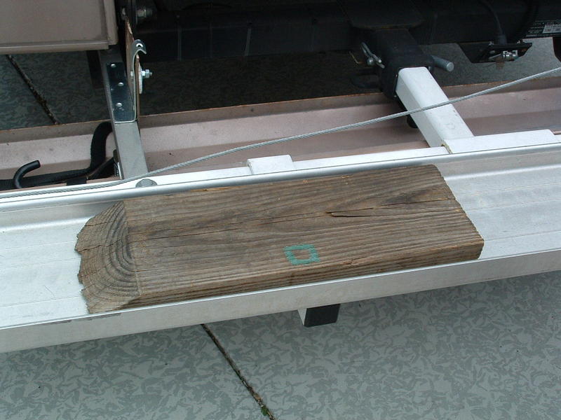

I’m cheap, I don’t need to tow, and I didn’t want that much more weight hanging off the rear of my 30’ gasser. So one I built a very simple lift for my Hayabusa:
2 arms (steel square tube) that pivot on the frame behind the rear wheels and extend about 2 feet beyond the bumper.
An aluminum ‘ramp’ (2 angle pieces and plate)
One crossbar connecting the arms (originally to jack the lift up; now I’ve installed an electric hoist instead to lift it.
When the rear of the lift is down, the motorcycle can be pushed on, and straps attached.
Then it’s raised with the hoist.
An additional feature is that the whole thing can be removed in 10 minutes.
I switched to the hoist after the aluminum ‘race’ jack slipped out three times - pretty intense when the motorcycle is on it. Never get under the lift when it’s being jacked! The jack works OK on pavement -- if you’ve very careful but proved dangerous on sand or dirt. The problem is that the crossbar (jacking point) moves rearward in an arc as it moves up. Plus the jack’s saddle moves in an arc in a different direction. I tried using blocks to do the jacking in two steps and it did make it safer. However, I switched to the hoist because it’s far safer, easier and cost about the same as the aluminum race jack.
pics: bike on lift in down position (the yellow blob is the hoist control)
bike on lift in raised position
bike off lift (yes the lift can be seen in the photo, try harder)
