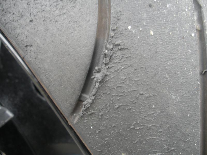

My little Gixxer came with PP2's and I am not impressed after riding them on the track. They shred like crazy and the front cupped pretty fast.

That is typical wear for a tire from a track day (not the cupping but the shredding)... You should have seen my Gixxer's front tire at the bash. I was from my last track day and was shredded worse than that on both sides. Just riding the dragon at the bash got my back tire to look almost like yours (not quite but close)... and I was running Q2's

That is because they are not a track tire
Pilot powers and other equivalent tires (q2, bt03 rs) are plenty capable for the track until you get into the middle of the advanced pack.
I run q2's at the track and run a respectable advanced pace and have never even had a q2 budge on me.
Jelly, that's not a tire issue that's a combination of tire pressure and suspension issue!
This is a proper race tire and this is normal wear after a track day.
Your issue is also tire pressure and suspension related.
Most suspension guys will tell you that Michelin tires are extremely sensitive to tire pressure. Some times as little as 1/2 pound makes a difference. Track guys who run michelins should check their tire pressure throughout the day as the outside air temperatures change to manintain grip and proper tire ware. A shreaded tire is always a sign of underlying issues.
