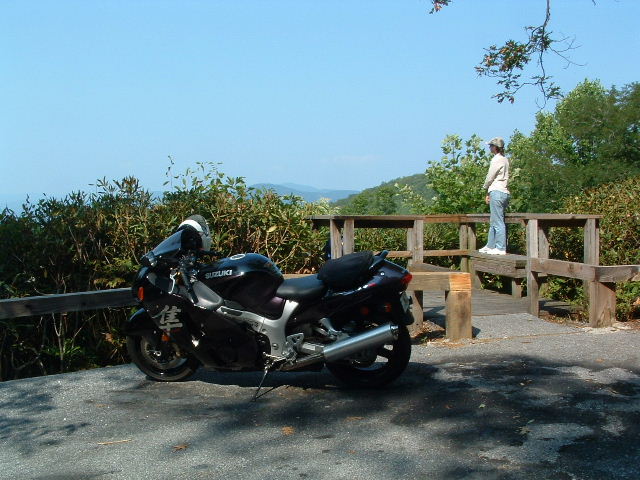

P.S Black Rock Mountain SP has a mini-tail of dragon leading up to it. Pic from a few days ago.

pic: stopping power somewhat limited now
