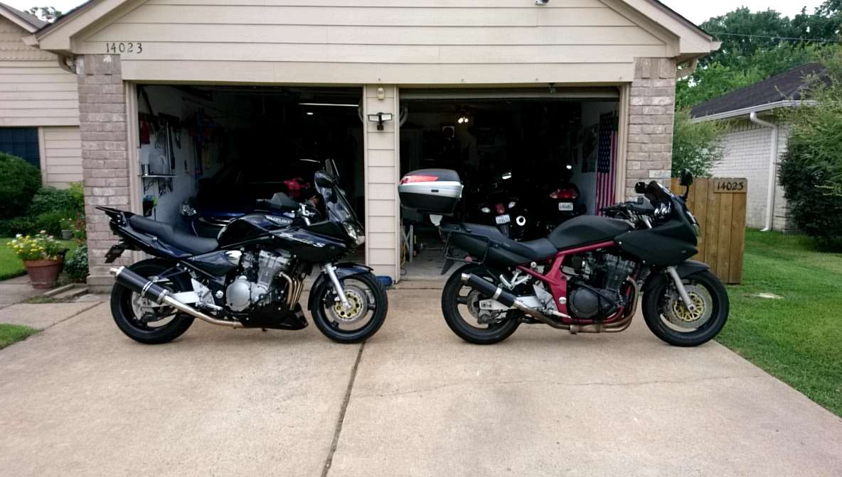

He bought a new Ducati SS, and retired his 2001 1200 Bandit. His wife (long time rider)
Decided to try the 1200. She loved it, but she is 5' 4" with short legs. She has been riding it for days now. However I felt the fall was coming. I called her early today, and said take the car your Bandit is Hostage!
A little, cutting, grinding, welding, and suspension tuning the Bandit was 2" lower.
Plus I had a extra seat that is lower than the Corbin saddle.

The 1200 has no room for adjustable turn buckle style links. This picture is on my wife's bike. Now 15,000 miles touring in Ozarks and other location's. I have personally pushed it harder than most could do. Failure is not happening. Rider error before those links / dog bones fail.

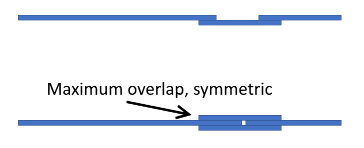

Bryan, your welds look great (much better than mine); and great to hear that you've tested them for 15k miles. I guess I would have done it a little differently ...
Nice and agree on 2nd image but no room on inside of bone. What you do not see in my images is the gap was filled with two passes then ground flat. In image were they are black laying flat on lift you can see no air gap like photo of on vise.
