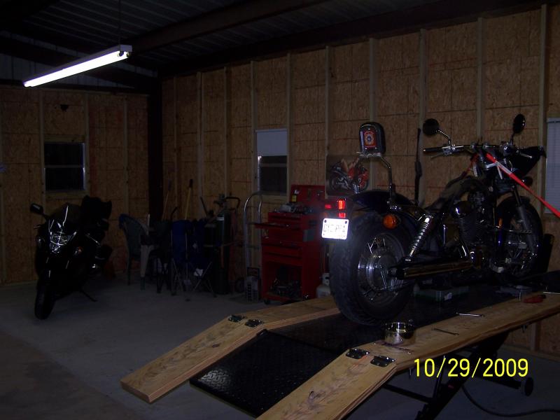

Here is the lift i have..
Bought it here. Direct Lift Pro Cycle XLT Air Operated Lift - Greg Smith Equipment Sales, Inc
Picked it up at the indiana store to save shipping.
One more thing, If you get this lift, Go ahead and get the side extentions. You can ride the bike on the lift, put your kick stand down and get off. Then all you have to do is tie it down. A one man operation.
