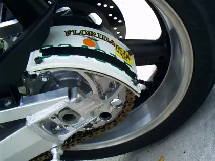

OK, so with all my bike mods, I forgot one thing... anyone have a good recomendation for a license plate frame?  When I installed the undertail removal kit from FSD, the tiny lip they give you is way to small for the license plate.  Well, I had to drill two new holes much closer together directly through the license plate to get it on.  I figure they must make a small 4 inch wide, or so, license plate brackets that have a full sized license plate frame on it?  Any suggestions?

I have the FSD undertail, so the only way I could do that, and this is what I currently have done, is to drill new holes in the license plate that are much closer together.  THe small tab they give you for the plate is not actually for the license plate, but for a license plate frame of some kind.  CLearly what I did is a hack and I would like something that is more secure.  THis "tab" is MUCH smaller than the license plate itself, maybe 4 incehs wide.  Hmmm..I really wish I could draw a picture on this some how to show what the heck I am looking for.

You could fabricate one.I went to Home Depot and got a piece of 1.5" aluminum bar stock. Cost me 4.95 for a 3 foot piece. Cut it and shaped it with a file. Polished it out and it looks great.

I did a similar thing Ice did. After cutting off most of the big plastic air brake (fender) with a Dremmel, I left an inch down in back only. I just took the stock license plate mount and screwed it into the remaining fender inch on the modified stock undertail way up under the tail light for illumination. No problems with cops since it is mounted about like stock only higher. I bent the tabs a little to have the plate rest more flat with the ground. The plate covers all of the tab and I bought small LP turn signals to replace the stock ones. They mount on the side of the rear fender I cut off. The new ones mount above that on the undertail. It looks really clean especially from the side, and it cost me only $25 for the new signals. To make it even more noticable, I added the signal/tail light integrator. Very cool! The brake lights flash when you brake too.

Hayabusa02, do you have as much of a lip as is on my Mototek tail? If so, I have an inexpensive solution for you. I used a piece of aluminum siding, cut it the same size as the plate.....with a mounting tab on top. Then I drilled the same pattern in the tab, the tail, and a small piece of aluminum bar. I used the bar to back up the fiberglass. I rattle-canned the mount with black epoxy paint.....it still looks good, two years later. Put stainless fasteners through a washer, the license plate, the mounting plate, rubber washer (between the the mount & the fiberglass), the tail, and the back-up bar. Fasten them with lock washers & Essna nuts....this setup has survived years of various abuses, and cost next to nothing.

Hayabusa02, yes it's part of the piece of aluminum siding I used. You just lay your license plate on the siding, and trace the two sides and bottom. On top, you trace in 1 1/2" on each side, then vertical lines extending 3/4" up....then connect the two 3/4" vertical extension lines at their ends.
So now you have a rectangle the same size as your license plate.....with the exception of a 3/4" X 4" tab on top. It's all one piece. I cut & filed the corners round.....just thought it looked better. I also put a slight bend (maybe 20 degrees) where the tab meets the plate.....so it wouldn't stick straight down from the mounting lip.
