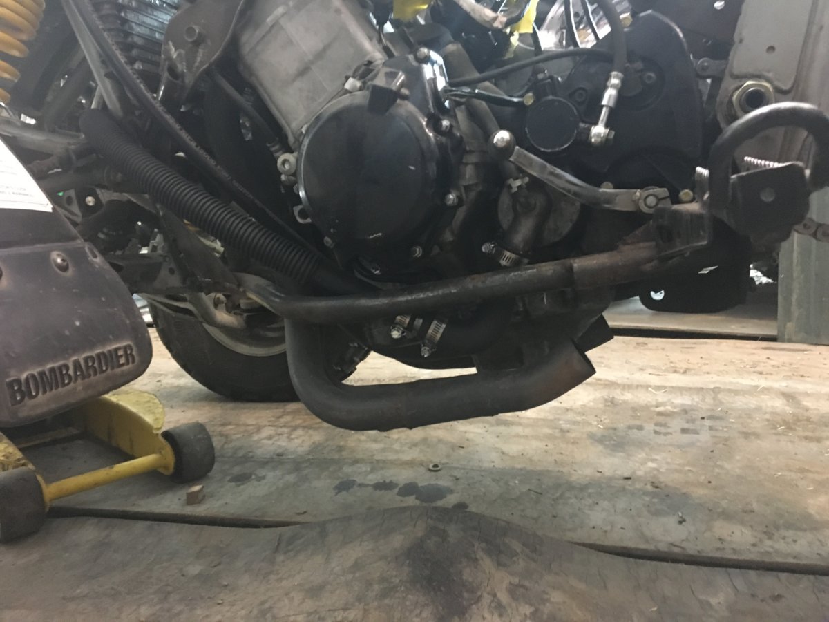

I have an 04 busy motor in a quad. Just getting it finished up and at this point the exhaust is cut off where the header goes into 1. Wondering if I need an exhaust on it or if I can just turn it out the side where it is. Also I can't get it to go into neutral.

As long as there is some sort of a header there and your not coming right from the engine manifold you should be okay but the lack of back pressure will really hinder your performance. I ran a dumper off my Yosh 4 - 2- 1 header for a half season and I lost a good part of my bottom end power.
A few guys here I know have some used slip ons for sale, if you or someone you know can get a little creative with a welder you can prob fabricate something up and use a slipon pipe.
As far as the neutral, we need a little more info... have you tried getting into neutral without it running? Are you certain you are able to get it into first gear? Maybe there isn't enough downward travel to catch first gear.
You could pop the linkage off and just secure the linkage squeeze clamp back on the shifter shaft and see if you can get it to go into neutral turning that with a pair of pliers.

Re the neutral selection problem, can you give us some more info on this, like is it only when the motor is running, or both running and stopped. Has the motor been apart or had any clutch work done recently, a bit of mechanical/service history would help.

I don't know any history on the motor. I bought it opff eBay. Can't get it in neutral stopped or running

Yes it is in. I will take some pics and post for you later today

. 2001 CanAm DS 650 frame 1300 busa motor
Looks really cool.
I would make a double Y shaped header with a U bend perpendicular to the down tubes, and come straight up into a gradual 90 degree bend, and have a pipe on each side going straight past the center of the cylinder block, extending out to under the rear fender, attaching to a muffler on each side. Or making an H pipe behind and above the rear shock into one muffler.

This may be a problem? Check the linkage may have been in an accident. Doesn't mean it won't work may not be happy where it is. May have to be a little rough with it while backing it up.

I feel pretty stupid now but once I got looking at some pictures I seen that the bike has linkage for shifter and I am just using a shifter off the quad so 1st is at the top then neutral then 5 more gears down
