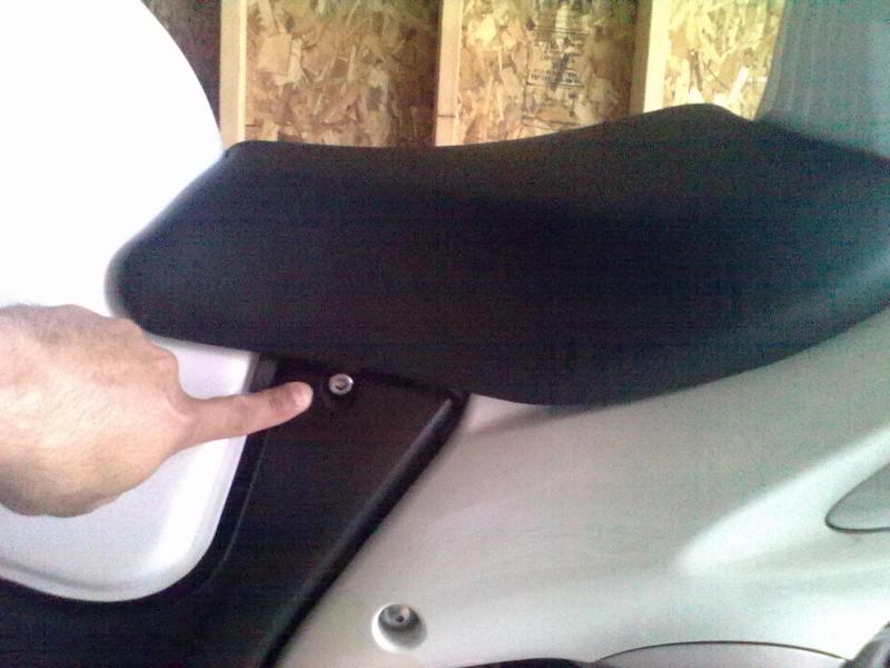

The battery is right under the seat, just remove the two bolts (6mm) that are by the seat on the frame (one per side).

After you remove both bolts, pull the front of the seat up, and theres your battery.
