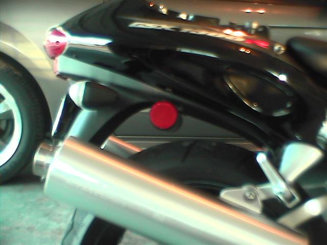

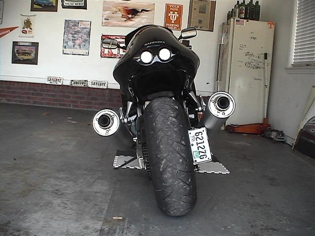

here are some pics before and after
took me and my brother about 3 hours and a 12 pack
