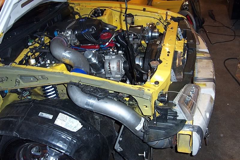

After years of buying kits I gained enough knowledge on how to make my own, for my Mustang.  Turbo kits are very simple but with the right quality parts, and a good coating, you can build it right.  I would love to see someone build a twin turbo Hayabusa setup with two smaller turbos, that would be interesting to see how it performs.
PS - Those wacky Australians are crazy about turbos!!!  I LOVE IT!!!
heres a few picks of the kit i built although it is on a 1000 you can look at my projects @   twowheelwerkz.com for more pictures of the build
