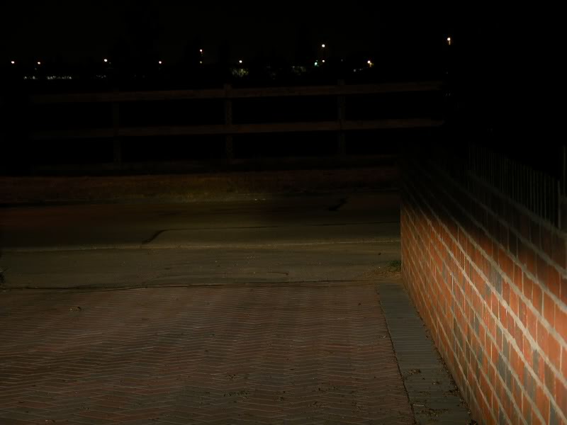

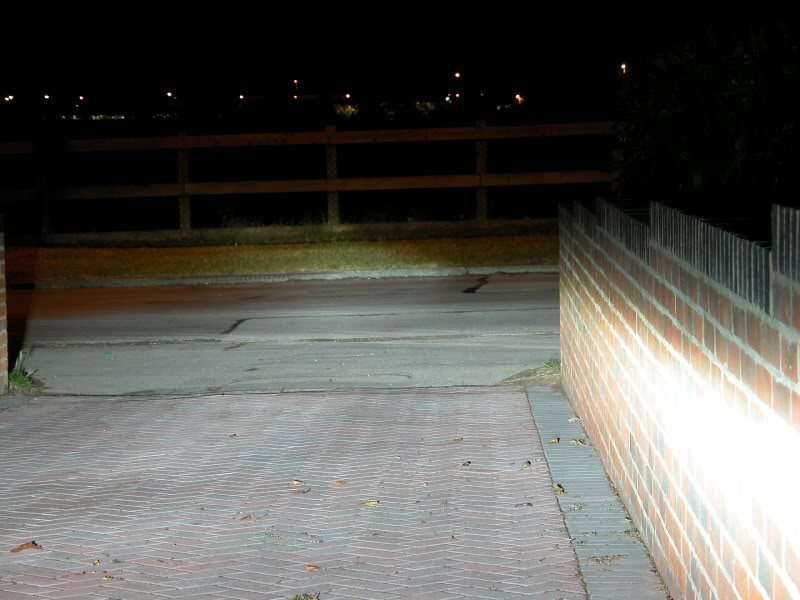

Check these out.
6K and Yellow High
Before
After
The blue is not that bad. I light up 3 lanes of the freeway now at night. I've be caught out at night with my dark shield on my helmet and still was able to see very very well.
