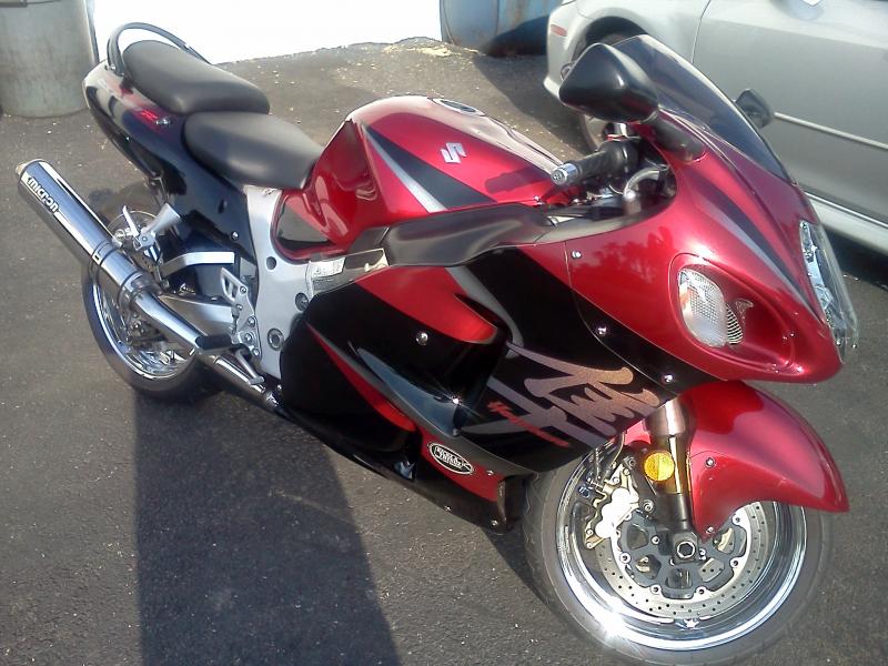

I have a 06 Busa that I'm getting ready to get painted but shop wants me to break bike down. I have never done this before I need some help how do you remove the tank?? Just looking at the bike everything else looks pretty straight forward..
Thanx in advance....

Thats my plan get the bags with the labels on them... BTW I love your bike man...
