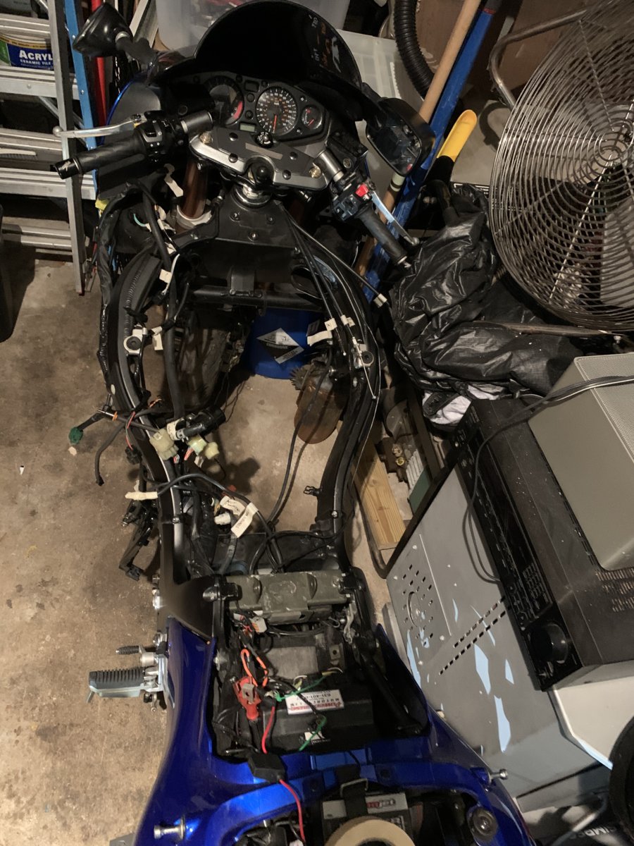

Had an hour or two this morning to start working, gotta go to work for a little bit and then it’s back to swapping!!
Fairings off, throttle bodies off, electrical all labeled and photographed, bolts all bagged up and labeled , next up are the oil lines, coolant lines and exhaust
