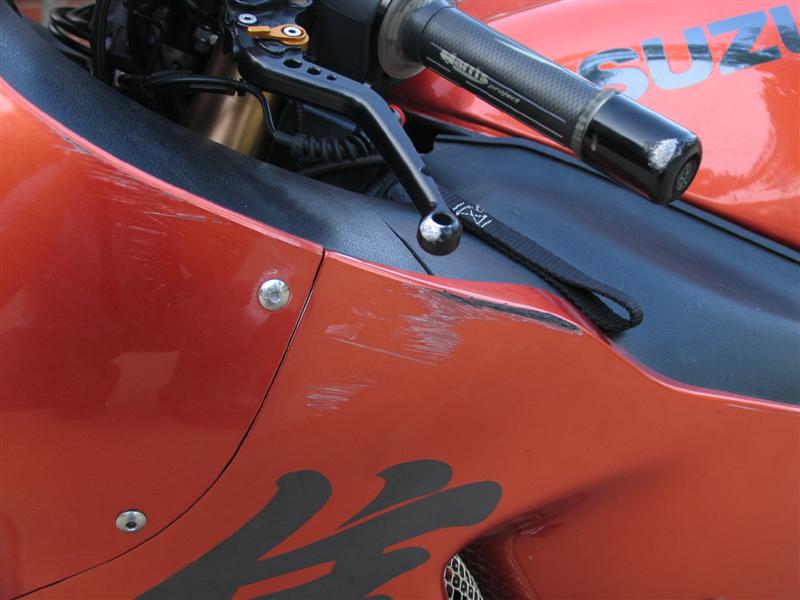

Mine slid 30-40' down the track. It took 3/8"-1/2 off the frame slider, a bit off the woodcraft cover and slider, Some of the swingarm slider. The fairings scratches were minimal. The tail made it into the plastic pretty good.
I was happy with how they performed. I don't expect them to save the bike from a 60mph crash, but they served thier purpose pretty well here.
