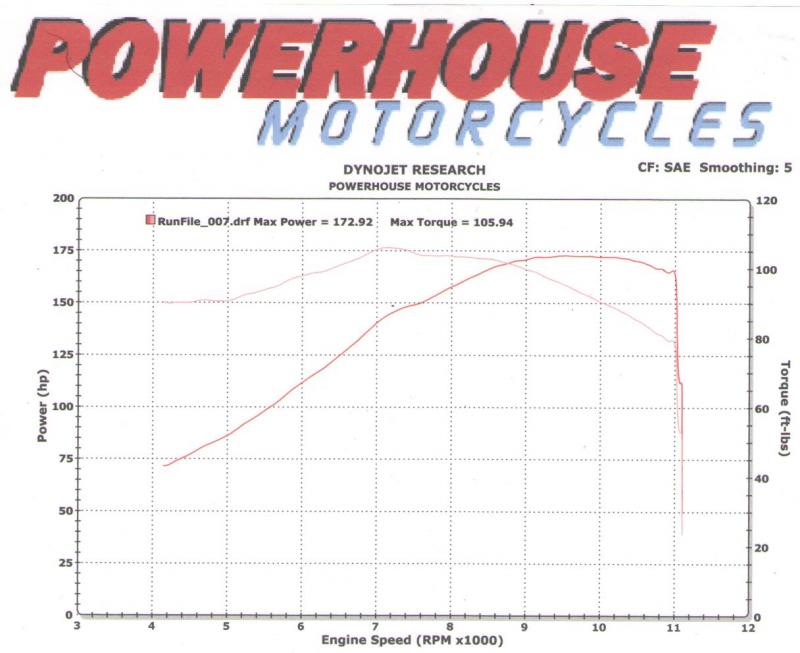

Okay, so we will do a build thread for this one as well. This is what we are starting with. Note that this bike has Yoshimura slip-ons and a powercommander, and actually made LESS rwhp than the totally stock Gen 2 Busa we are working with in our other build thread. FYI- that is a red flag that the map in this pc is not doing justice to the exhaust system, I would have expected to see more. A custom map would have made a difference here, as it always does, contrary to popular opinion. No matter, a turbo will fix this problem right up!:laugh:
POWERHOUSE has an update on this in regard to the powercommander. Once up on the dyno, we found that our TP input was not working properly. On further inspection, the reason was because the powercommander was not installed correctly, and was actually NEVER working on this bike. FYI, it was installed by a Suzuki dealer who I will not name, but will say this: this dealer was suggesting to the owner of this bike that they would have no problem installing a turbo kit . . .:rofl:
