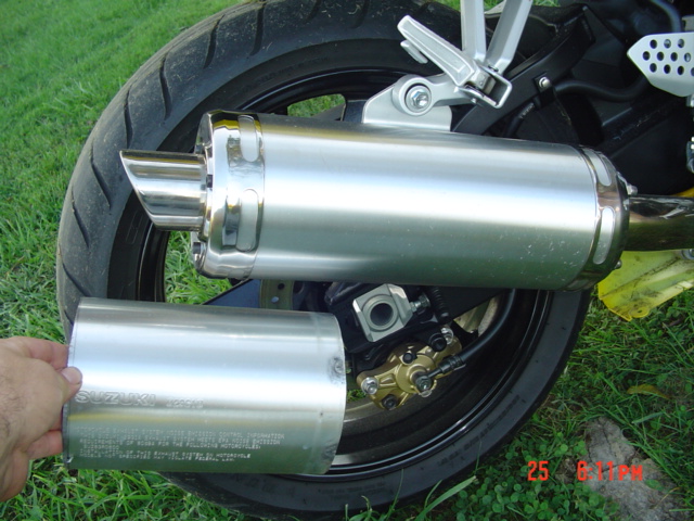

Here's the shortened can:
uh i missed the CF part........

after mod 1[/url]
after mod 2[/url]
It might take a few minutes....Just uploaded them
