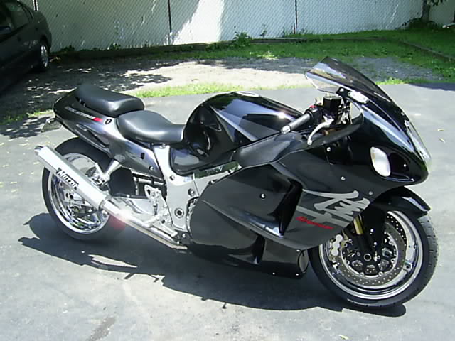

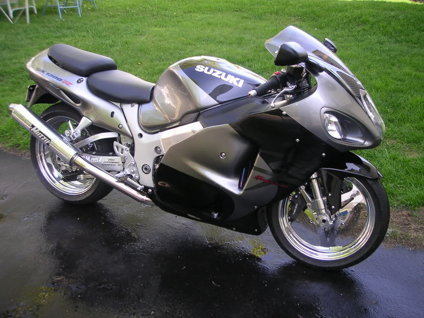

00-03 750-and up gsxr1000 are a little bigger and look pretty good..
I put a Gsxr fender on My Busa back in the day when they didnt bolt on and think they look great!!
They bolt right on to the newer busa so if you dont like it you can just change it!!

I really like that. You're right: it DOES look a lot better than both the original and the newer gsxr fenders.
GsxrBots
So the 00-on up will bolt right on to the Gen 2? I bought a scuffed up '07 one thinking I needed the newer gen one. If these will bolt on, I'd rather have that bigger fender than the smaller one..
E-RACER
yes it will..
The black bike was the 2nd one I did in 01,nice that the factory GSXR fender was a perfect color match also!!..Mine was a SRAD fender,smaller,and I had to weld stuff ect..
The bigger fender to Me looks perfect!!
