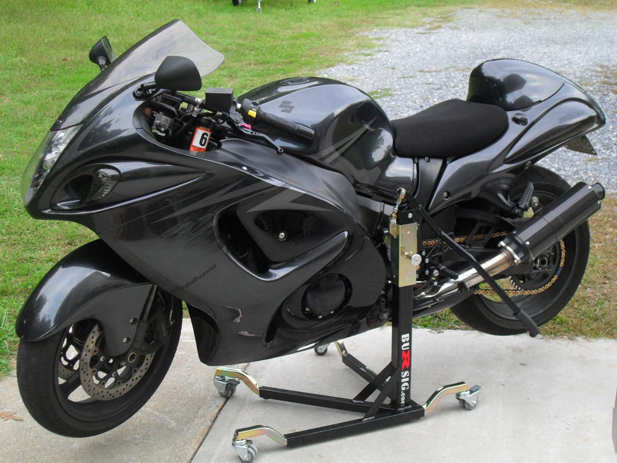

Not true.
Being lowered with another kickstand effects nothing.
The plate on the stand lines up to the frame the same. The plate moves up and down on the handle, so a lowered bike or a raised rear has no effect on alignment.
The legs of the stand do not interfere with the kickstand either, stock or lowered
I set up my Bursig on my Busa, without issue.
I later got a B-king, which sits higher than the Busa, and set the Bursig up on that as well.
The lower pin needs to be smaller for the B-king, so my Dad turned it down to the correct size in the lathe, rather than me buy a new pin.
I also still have my Bursig, and it's waiting for my next gsxr1k.
If you've never owned or used a Bursig, you can't comment on how to set it up, or say it has problems that it actually does not.

Also not true.
Once set up, the Bursig rolls up next to the bike, hold the bike upright and raise the kickstand, the stand's pins roll right into the holes, let go of the bike, as it's now held upright, push the handle down, and the bike raises up and the lock pin on the stand locks, and it's done.
Greatest and easiest stand I ever used.
