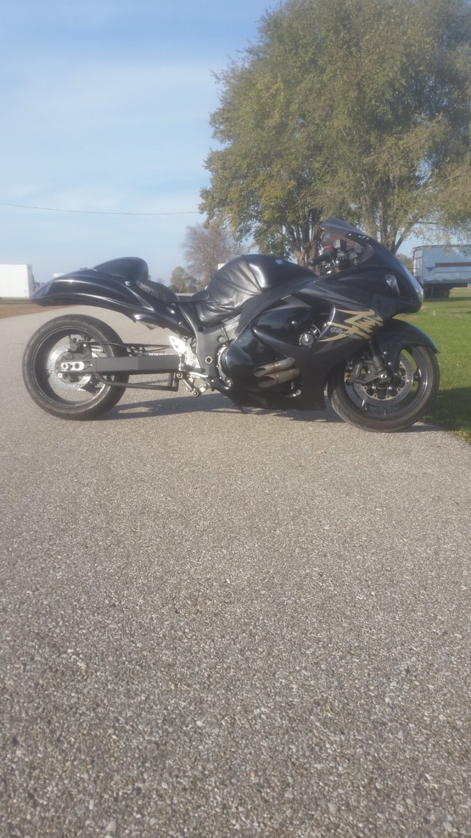

Gen 2 stage 1 turbo bike
Well made it out to the track for one last time. Happy I went and bike was running great. Still can't get a 1.5 60 foot out of it. On 2 runs I had a 1.6 60 foot but I was on the rear wheel going thru the beams. In a couple of months I will start talking to someone about doing the motor and a tune. Would also like to do a boost controller so I can do boost by gear. Goal for the bike next year would be 220 mph standing mile, and beat up on the ugr lambos and top speed built gtrs. Would like to see the bike make at less 350 whp. Going to a dyno day this week to get a print out of what it's making right now.
So went to the track this weekend with my blue bike but brought the turbo bike just incase I had problems with old blue. I did get a couple runs with the turbo bike. Not the fastest times but it was constant. I bought a new clutch master cylinder for the bike and added some jb weld to the clutch lever. So now the 2 step actually works when letting the clutch out. Made launching the bike a lot more easier to me. I will post videos later of the runs on the bike. Bike needs a longer arm as the bike likes to wheelie.
