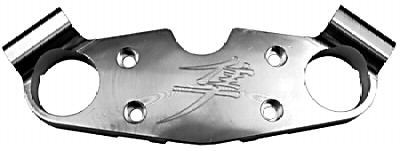

(edubb1971 @ Jun. 29 2007,01:32) or maybe an aftermarket top clamp them you could raise or lower?

Depends on the method. Using spacers will effectively raise the bars closer to the windshield and could cause an interference.
Using an aftermarket triple clamp moves the handlebars a LITTLE forward which could also cause problems.
I have this clamp, and I had to adjust (rotate) my bars a smidge so they don't hit.
That's one of the triple's that I like too... nice. Maybe i'll just leave mine alone, LOL Very tough to do though.
