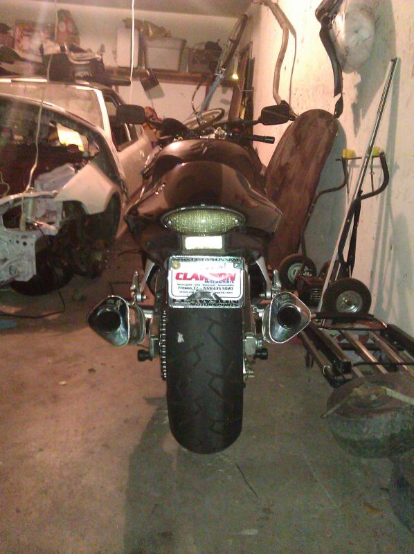

Yea heres what im working with...
bike almost stands upright on the stand...
Yeah, that looks bad, it's just waiting to fall. Another thing to seriously consider is a lawsuit. It's unlikely, but if the wrong person or person's kid bumps that thing and it falls on them, look out. Now common sense would tell you that they need to pay for the damage to your bike, and rightfully so. A good lawyer however will have you paying them, even with a good stand, you'll get burned with that one.
It's gonna be when your bike falls, not if. The first fall of mine was caused by a very small dip in the concrete at the gas pump it was parked at. As I began to walk away, crash, and it was in gear. You'de have to be too careful with that not to worry about coming back to find it on it's side eventually.
Just bite the bullet and buy the stand, it'll pay for itself many times over, and I hope you never find out why.
