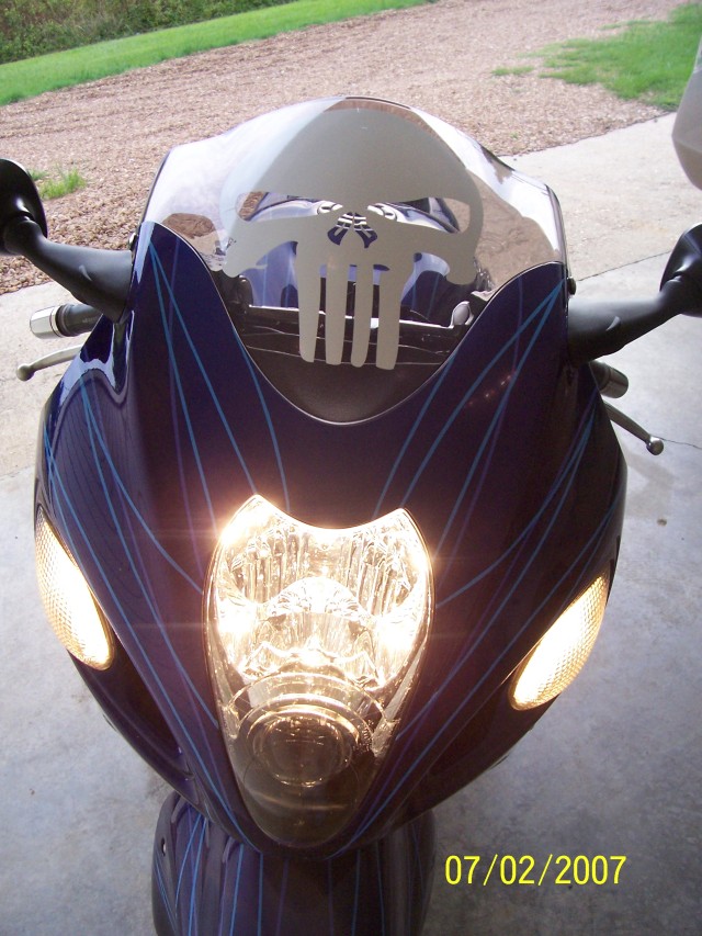

more like park lights. Yes. Do a search on park light mod. here's a pic of mine with HID's installed
