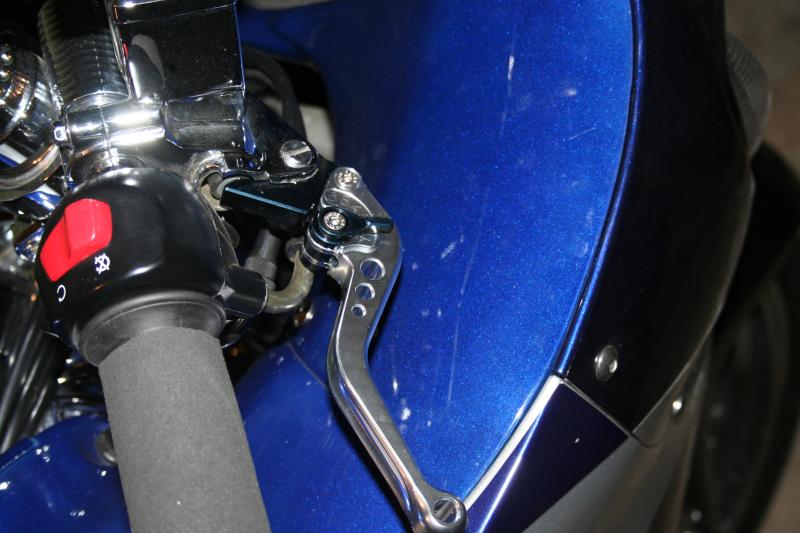

Chinese levers arrived won't fit
i am guessing he meant .020 thousands or .5 microns,, half a millimeter. i would sand down the chrome on the leaver. a good hand file will give you a flatter surface than a dremmel tool. mask of the part that shows and slowly sand down the chrome.
I've never heard of chrome being that thick, iirc that's closer to hard chrome specs, x2 on the hand file. Also fwiw if op measurements are accurate your talking about the same thickness as human hair. I don't really see a part not fitting at all to fitting correctly In that small amount of space

I was using his numbers.. when we machine our parts and send them out for chrome its usually get .003-.010 for chrome or even cad. His actual measurement of .010 made more sense, either way file em down and use em.
OK update on the levers. I took you guys advise and sanded down the clutch lever. First with a grinding wheel and then with sandpaper. fit is very good. they both feel great, the brake fells allot more responsive than before, i guess it's because of the adjustments I made to the lever I can now get a much better grip and pull. thanks for everyone who responded and who gave advice. here are some pics.IMG_0173.jpg
