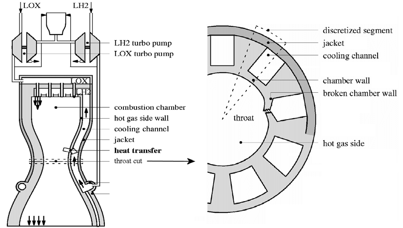

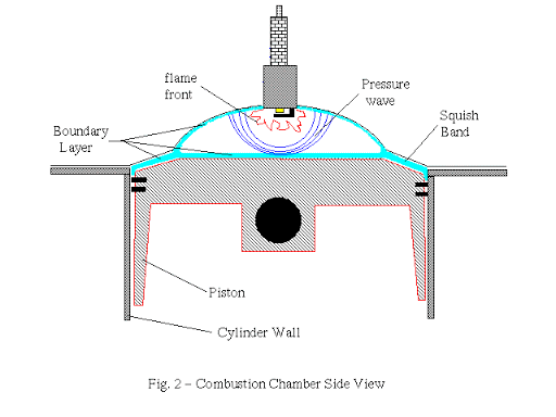

Thank you, chamber wall is probably called the cylinder wall (first pic seems to call it a chamber wall, 2nd calls it cylinder wall). They didn't specifically say it had scoring just that it was an uneven surface and compression was low in only one cylinder. I don't have the means to pull it apart right now, I moved in with my father to help him start a business and it turned out to be a huge mistake, place is a mess and he loses my tools. Moving out in a few months will at least have a safe place for my tools. Do you think it's a terrible idea to ride it as is? I mean it's still fast for me and I haven't lost a race to any of thes cocky street racers yet lol. I'm still considering increasing the displacement of the engine, is that not done by boring out the cylinder walls to be bigger?

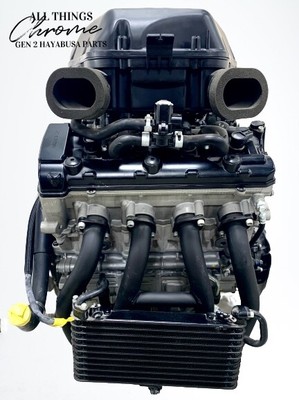

Just in case you do find a little change laying around. All things chrome are selling BRAND NEW gen 2 busa motors on eBay. COMPLETE, header, air filter, oil cooler, free shipping. $4500
I neer knew it was possible to get a brand new engine without buying a brand new bike. Must be pretty rare to find these available.
Its not possible and very rare,they just got lucky and someone else had already bought the bikes and pulled the motors before the company went under. The guys that make the t rex sell off all the frames and body parts after they strip the motors because suzuki won't sell the motors separately and makes them buy the whole bike.
