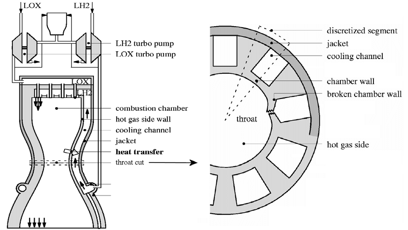

After 20 years, I still have work at learning American English. What is a chamber wall?
If you have scoring of the cylinder bore on only one cylinder, it is unlikely that the rest is OK. Time to pull her apart.
Thank you, chamber wall is probably called the cylinder wall (first pic seems to call it a chamber wall, 2nd calls it cylinder wall). They didn't specifically say it had scoring just that it was an uneven surface and compression was low in only one cylinder. I don't have the means to pull it apart right now, I moved in with my father to help him start a business and it turned out to be a huge mistake, place is a mess and he loses my tools. Moving out in a few months will at least have a safe place for my tools. Do you think it's a terrible idea to ride it as is? I mean it's still fast for me and I haven't lost a race to any of thes cocky street racers yet lol. I'm still considering increasing the displacement of the engine, is that not done by boring out the cylinder walls to be bigger?
Schematic-of-a-regeneratively-cooled-rocket-engine-combustion-chamber-The-drawings-are.png
