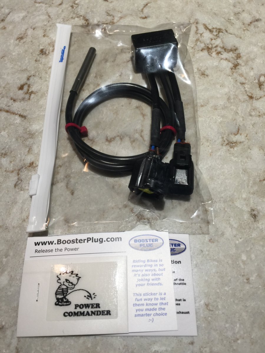

Finally got the booster plug. Not sure how much use I'll get to report my findings since I live in central New York.
So far looks good. Good instructions, 10 minute install is a plus, cool sticker included.
I'll get it installed in the next few days and if we have some decent weather, I'll test it and report back. Otherwise this will get rehashed in the spring.
