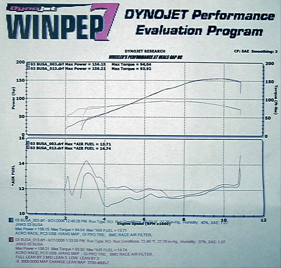

Dear friend, looked at this dyno chart.
is the dynamometer in my Busa, with yoshimura slipons R77 and after changing to Ti Force full system with dual slip ons. The power is more everywhere, not just on the high rpm.
I disagree with you is not the way you describe it.
The only one you will need in the full exhaust system is a good dyno setup and a new map.
Good post whiteBusa but I'm fairly certain there are other things at play forming the differences in our experiences as I don't believe either are imagined. LOL!
What I'm thinking here is that your Busa is most likely a Euro spec Gen II where your Busa was still left exhaling through a CAT with the Yosh slip-on's while the full system TiForce exhaust did away with the CAT which in turn made a very different difference as compared to what I experienced of cat-less systems and BTW?...Very Nice Numbers! :)
So in this respect?...this does toss a wildcard into my opinions concerning such but here again I find myself in a tug-o-war asking..."So How Much For How Much and How Much Is Too Much?" LOL!
I'm no longer of the mindset that "I Must Have Every Available Pony" because the simple fact of the matter is be it my Busa or This ZX-14 or even my old FZ1?...I've rarely if ever been in a normal riding situation where I thought..."Dang...I didn't bring enough bike!" LOL! and I do like the price-point of the Coffman's and I also like the fact that whether I throw my riding jacket over the saddle or lock my $500 Shoei on the bikes helmet lock?...nothings going to burn, boil, bubble or melt! LOL!

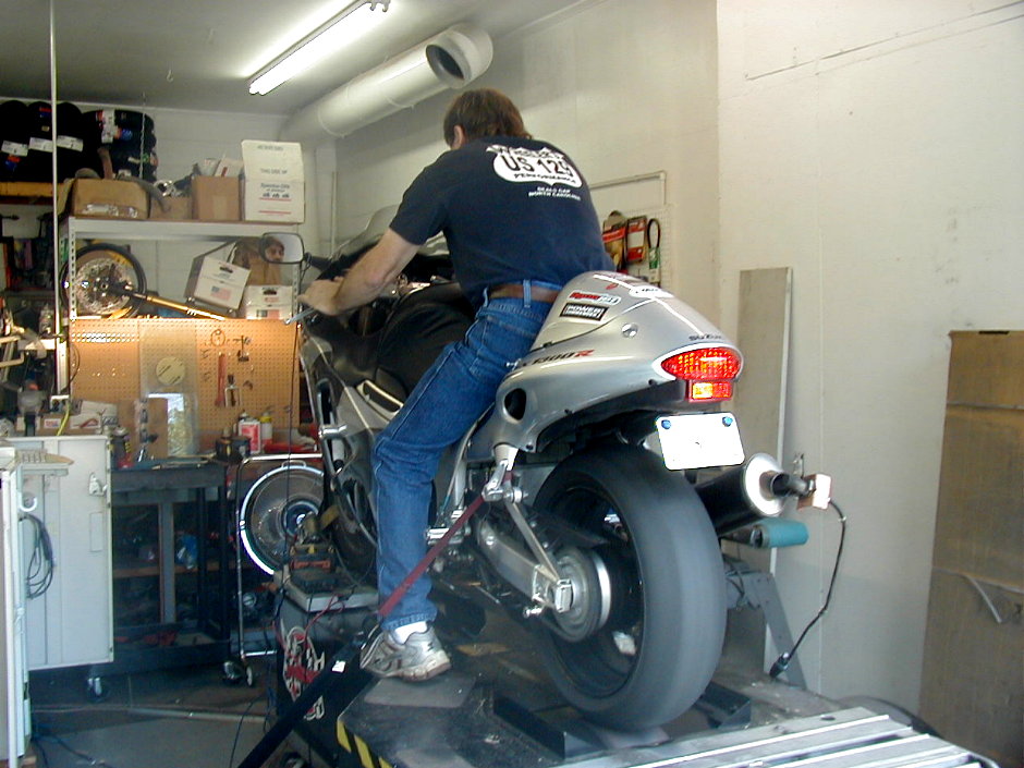

here's some pix from my past...
My friend JINKSTER I can understand the way you think.
I believe the value of an full exhaust is not only evaluated by the increase in power.
It is also the weight reduction, and overall quality., which also appears in the image you uploaded.
