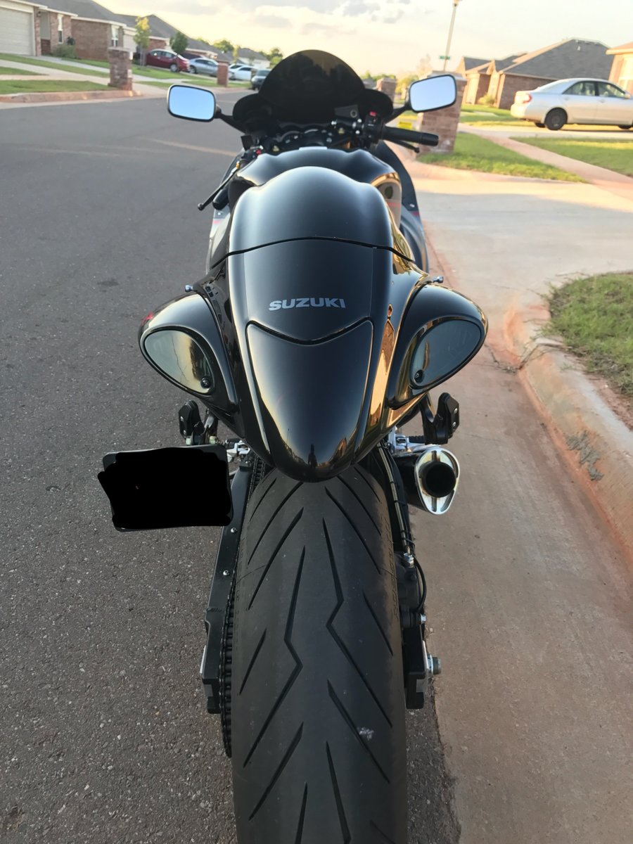

I need some advice. I want to add a 8+ stretched swing arm. No blocks. Just to get the back tire out a few inches. I know I have to change the chain and get longer brake lines. My question is should I step up the rear sprocket and drop the front? I’ve done a stretch before but I’m more than Capable of making it happen. Feel free to share your knowledge and suggestions on parts. Thanks In advance

this is/was 8 over with a stock tail... its also lowered.... I smashed the tail-light and it rubbed badly when riding a passenger.... u really need a tail... like the guys said .. (probably also a stronger spring at a minimum)… if u want this look... these things have to be done... as far as the swingarm... its a trac dynamics swingarm that included all bearings and brake bar... from time to time they are 500 bucks on ebay… happy hunting... right now there is a 6 over trac arm for 495 … this is the best deal going..

even with my ass end up in the air.. it still rubbed under a lot of throttle, and 2-up FORGET it.... look at my tail section.
