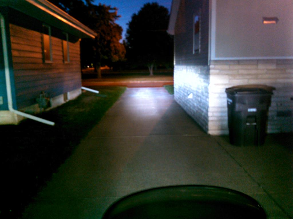

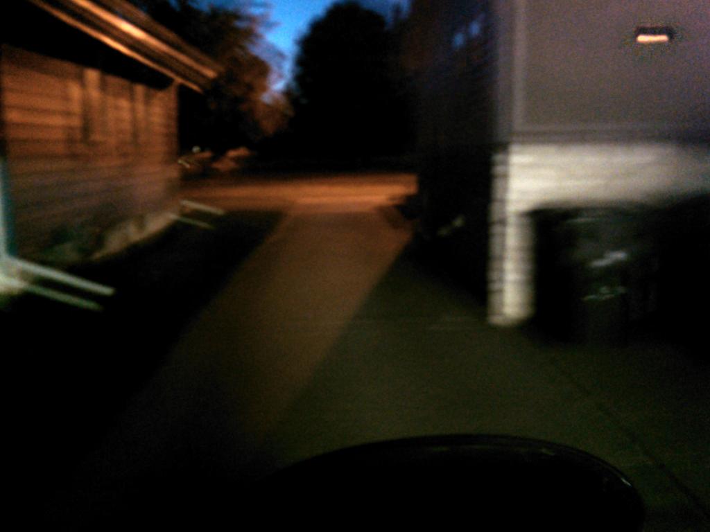

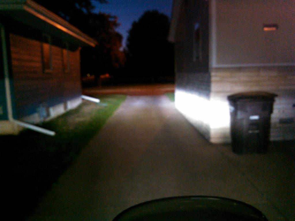

Do you have pictures of how yours look at night?
Here you go.
I realize that I am not a photographer, so yes the pics are not the best, these were with a point and shoot camera in manual mode to try and show the differences in light output.
Ambient
LED headlight, low beam
LED headlight, high beam
LED headlight WITH auxiliary lights. You can see why I run auxiliary lights on my bikes.

Man, that's amazing with those Aux. lights!
yea them are bright wow! aux lights just look like shiit on a Busa tho. they make it look to touring. unless one cud flush mount them into the fairing and look factory then it wud look decent. but the ones hanging off the side just ruin the look of a Busa imo. it turns it into an off road lookn trail bike.
