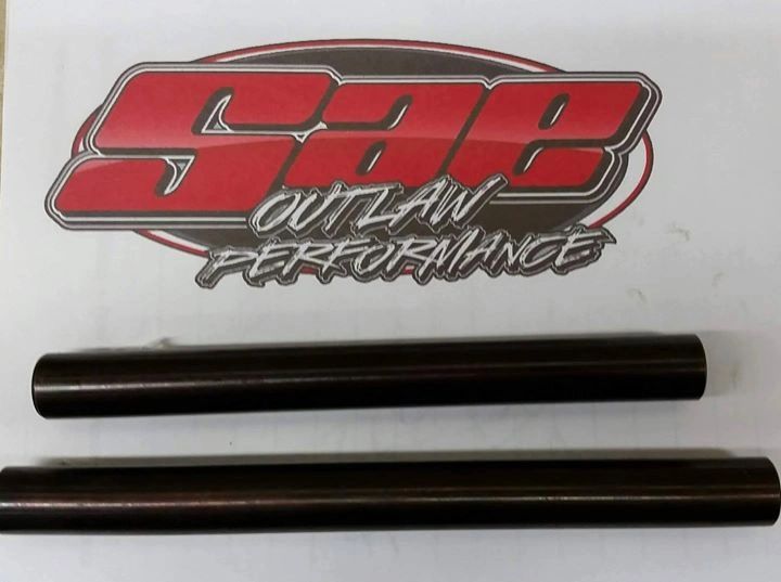

I said the shafts, not forks.
As for shafts, SAE Outlaw Performance, is the most reasonable at $42.95 for a set
Forks OEM, or there are aftermarkets, that will run almost $1000
