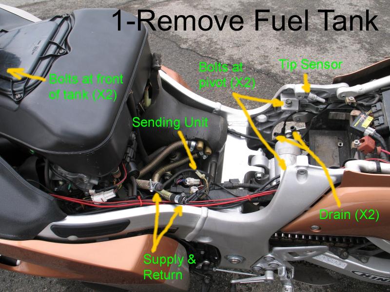

For the past 2 years, I've been having trouble with my 99 Busa (19,800 miles)...it cuts out around 6,000 RPM, stalls while idling, has jerky acceleration, and hard starts. I couldn't even leave it idling long enough to open the garage door without it dying. I think there are atleast a dozen other 99-00 owners around the oRg that have also been fighting this problem. I've done everything from replacing kinked fuel lines, to cleaning the injectors, to cleaning the in-tank filter. But they weren't the real issue...
I just got done replacing the 2 fuel pump filters, and thought I'd post some step-by-step pics. Some of the stuff is pretty basic, but I'm glad I put them all up because I just realized I forgot to tighten the 2 velocity stack / throttle body clamps on the bottom of the airbox after seeing these pictures.
Now it starts instaltly, has no idling problems, and has yet to cut out under acceleration. It was about 2 hours teardown, and 2 hours re-assembly, but will probably take half that the 2nd time around. :beerchug:

That screen is gunked up eh ?
Did it's job. Video says it all. Flick and on! :)

Thanks Blanca. There's been alot of discussion around here recently about this, but I couldn't find any pics.
As dirty as the input screen was, the output filter was just stained...no particles or gunk there!

Great writeup. I had to do this too on my '00. It sucked. No directions so it was carefully taking things apart. Got gasoline all over the place.
One thing you did not show is in Pic #6 I think, I also took the left side apart. There is a tiny screen on that side about the size of your pinky nail. That was clogged on mine and bike ran like crap when the tank was 1-2 gallons in the tank. Fill it up and ran like a top. Odd problem.
Replaced all filters & seals, plus cleaned out that pinky-sized mesh screen.
