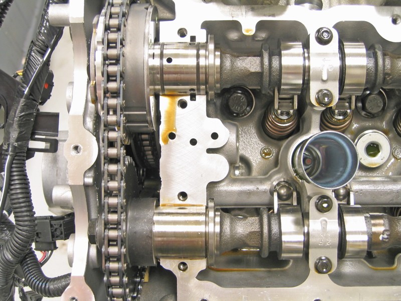

Below is a pic of two cams by themselves and other pic is with them installed.
You can see the cams running crosswise with valves and valve springs in line with them.
