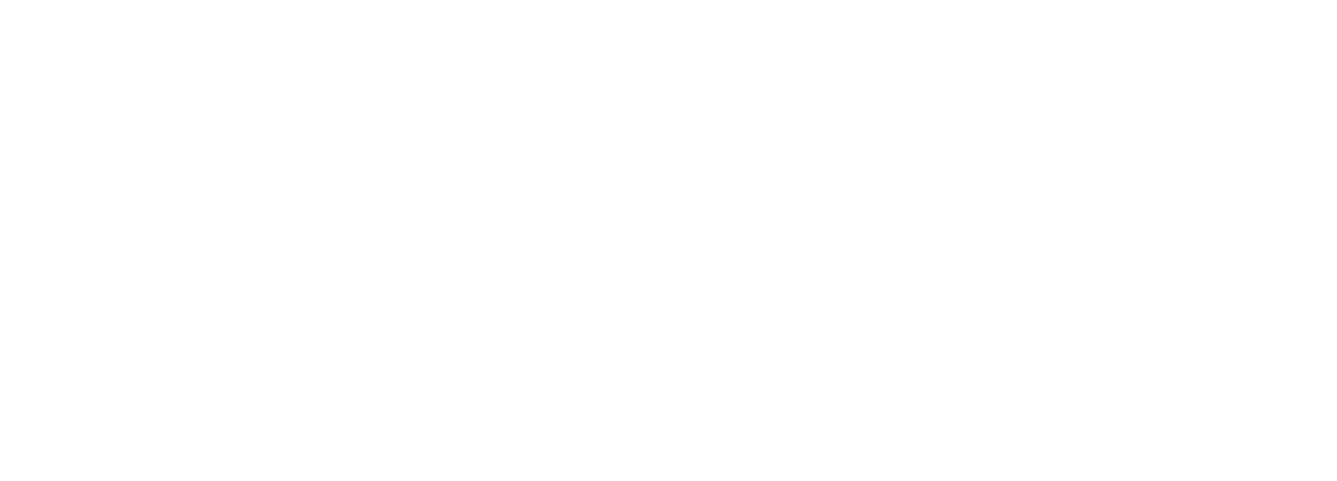

Sample of a HPC NOS tune on a 210 HP motor with a 30 shot of NOS. Progressively gets fatter up top to compensate for additional RAM air at speed... NOS activated at 7K progressively. 5th. gear pull...

That graph looks perfect, nice job greg..
Reply With Quote
Thanks Sir, still learning but having fun in the process.
