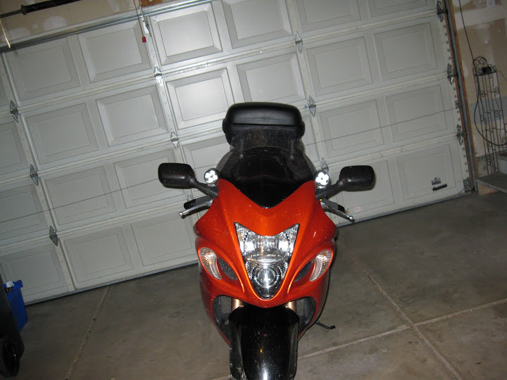

    Just wanted to share my light install in case anyone else is interested in adding some massive light output to their bikes.
    I used the following lights - Quad CREE XML T6 - 3000Lm:
    Quad CREE XML T6 3000Lm 12V 30Watt LED Auxiliary Light, 24x7 Diy
    With the following controller (wiring diagram on page as well):
    Waterproof Wireless LED Dimmer with High Beam Bypass
    I mounted the lights up on my mirrors, but you can put them anywhere you want.
    Lights:
    Wiring runs under the top plastic on the dash - not pretty, but can't be seen unless you're on your knees :
    For wiring I used a fused harness off the battery, connected to a relay mounted under the tank/front seat. Then ran the power from the relay up to the front of the bike near the fuse box.
    Power wire:
    In the picture below is the wiring. The blue lead is the trigger wire for the relay tapped into the low beams. The purple wire is the full power trigger for the LED controller tapped into the high beams.
    Wiring:
    The controller allows the LEDs to be infinitely dim-able via the remote key fob, and jump to full power when you switch on the high beams.The other two sets of connections are the power from the battery/relay to the controller, and the output of the controller to the lights. As the wiring sizes were mismatched, I used Posi-Twist connectors. Pic is before I tied everything down and cleaned it up.
    I did not use a separate switch as the controller has a remote control which suits my needs to turn them on off or dim them.

    Why not lower on the forks, like other kits?
    The main reason for the lights is a lot more vision at night, and mounting them higher gives you better/longer light field. Same idea as offroad racers that mount light bars high.
